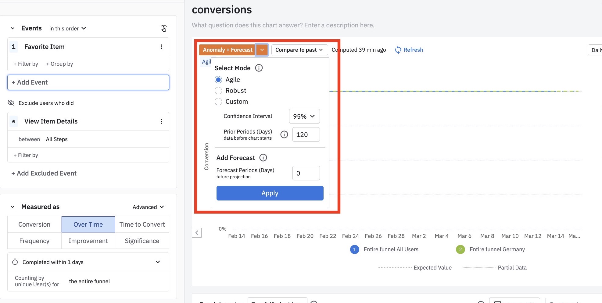

To set up anomaly detection, follow these steps:
  1. Click Anomaly + Forecast to enable the feature. The button turns orange when you engage the feature.
  2. Click the drop-down arrow to the right of the Anomaly + Forecast button.
  1. Select the mode. Your options are agile, robust, and custom. Agile mode adjusts more quickly to recent trends, using a 95% confidence interval and 120 days of training data prior to the beginning of the chart's date range. Robust mode is best for stable metrics, as it incorporates a full year of extra training data, and can therefore better account for seasonality. Custom allows you to change both the confidence interval and the training duration to fit your specific requirements. Higher significance levels tend to results in fewer anomalies appearing on the chart.
Note
Amplitude automatically detects seasonality in each mode. The duration depends on the amount of data used to train the model. Agile mode typically uses daily and weekly durations, while Robust mode looks for monthly and yearly durations. In cases where enough data isn't available, Amplitude may not detect or apply seasonality.
  1. Add a forecast, if you prefer. Forecast projects your metrics into the future, whereas anomalies are only detected within your historical data. To add a forecast, enter the number of months you'd like your forecast to extend in the Forecast Period field.
  2. Click Apply to begin detecting anomalies.

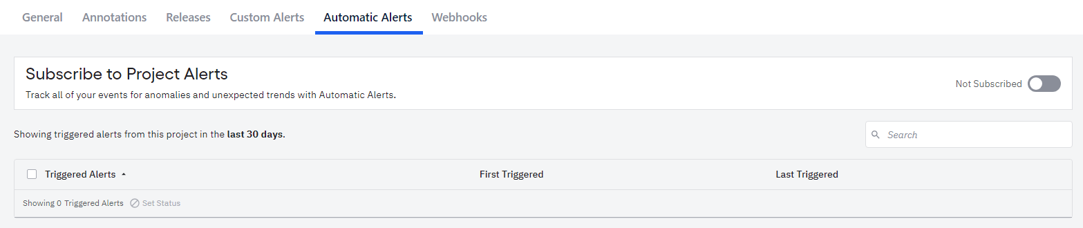

You can also request an emailed digest of all anomalies in a project. These digests are fully automated, and you can set them up for multiple projects. After you switch them on, they continue until you turn them off.
To set up automated alerts for anomalies in your projects, navigate to Organization settings > Projects, find the project you're interested in, and click it. Then click the Automatic Alerts tab and flip the toggle switch to subscribe to project alerts.
When alerts are active, Amplitude displays a table on this page listing all the alerts that have been automatically generated by the project. Click one to open the chart where it occurred and see it in context.
