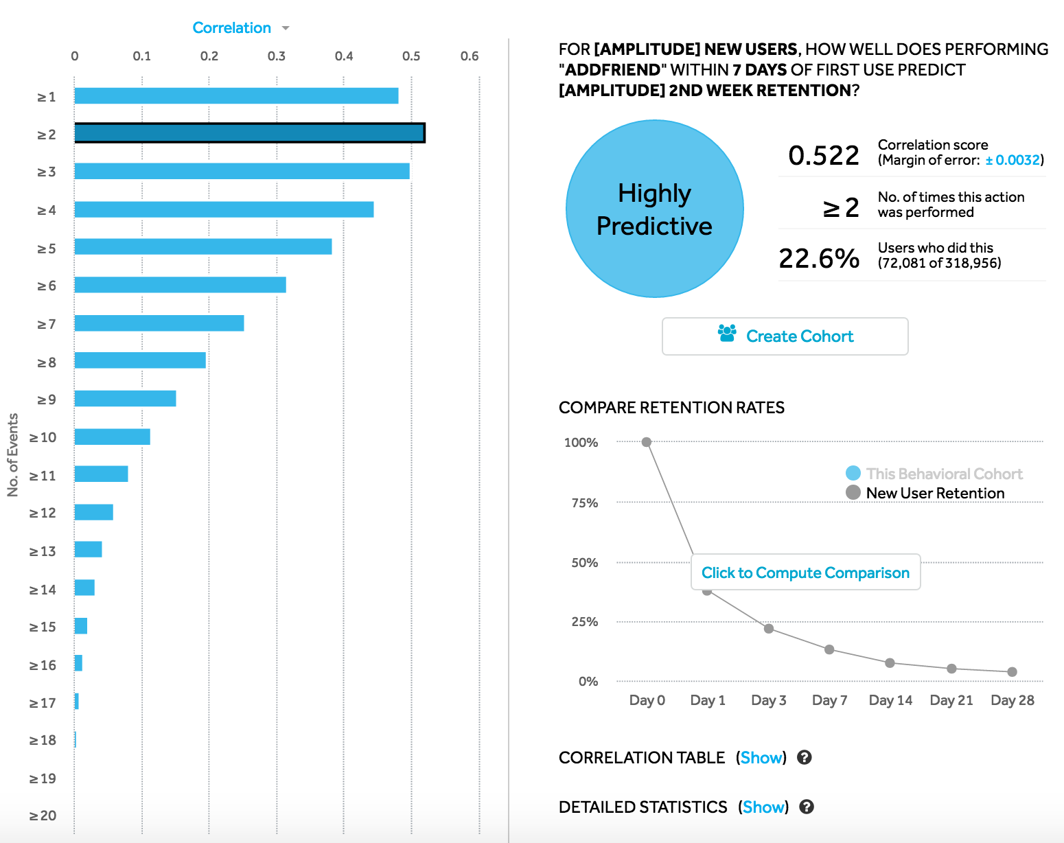

The best way to begin using Compass is to ask yourself which events might be good predictors of retention. After you select an event to analyze, start thinking about correlations that might reveal something interesting about user behavior.
Proportion above threshold
The proportion above threshold tells you how many new users triggered the event in their first N days. This matters because the sample of users meeting the threshold must be large enough for Compass to understand how well the event correlates with retention.
One way to change the proportion is to increase the number of performance days in the window (Amplitude allows between one and seven days). More performance days give users more time to reach the threshold, which increases the proportion. If you're investigating an event property, consider looking at the complete event, which may have a higher proportion above the threshold.
There's no perfect proportion above the threshold. Too low and you can't get many new users to perform that event; too high and you don't have any room for improvement.
In some extreme cases, a low proportion above the threshold can still produce a high correlation. For example, a web application that has high traffic but forces login for all new users.
This metric matters because it accounts for the balance you need to find your inflection metric. Returning to the Facebook example, getting a new user to add one friend isn't a great choice for an inflection metric, because most users do that already. But getting a new user to add 100 friends, while highly correlated with retention, is hard because few users actually reach that level.
