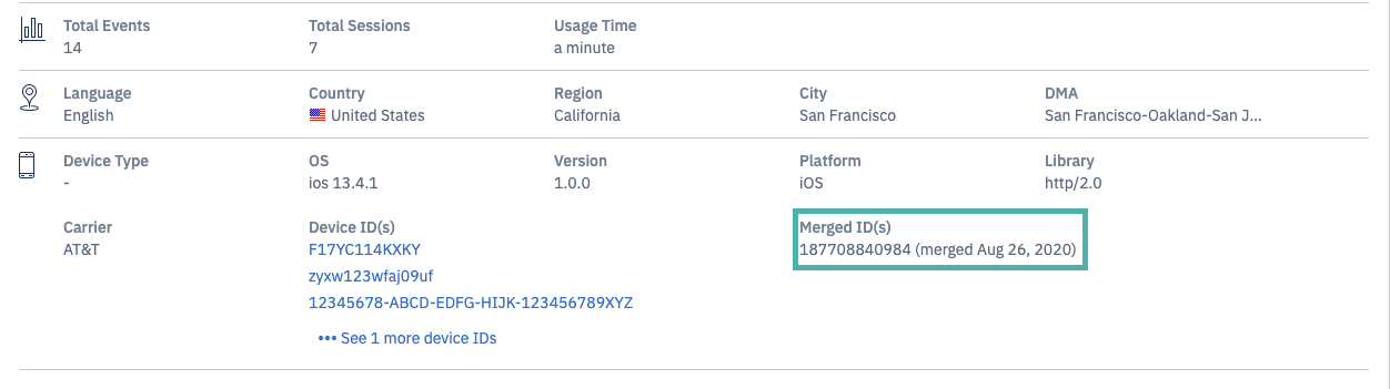

Merged users
The merged user problem arises when Amplitude determines that an anonymous user, for example, one whose only ID is a device ID—is actually a recognized user with an Amplitude ID.
For example, when a user gets a new device, they'll log events in your product anonymously before signing in. To Amplitude, these anonymous events appear to be coming from a new user, so they're mapped to a new Amplitude ID.
But when the user logs into their existing account, all subsequent events are mapped to that user's existing Amplitude ID. A couple of problems arise from this:
  • The user is counted twice in active and new user counts.
  • Events received while the user was anonymous are “lost,” in that they won't be attributed to the true Amplitude ID and the user's actual User ID.
Amplitude solves this problem by cross referencing the list of Amplitude IDs with an internal mapping of Amplitude IDs that have been "merged" (those that Amplitude has determined to be the same user). This all occurs when you query on the dashboard. You can view a list of a user's merged IDs in their User Activity page, along with the merge times.
