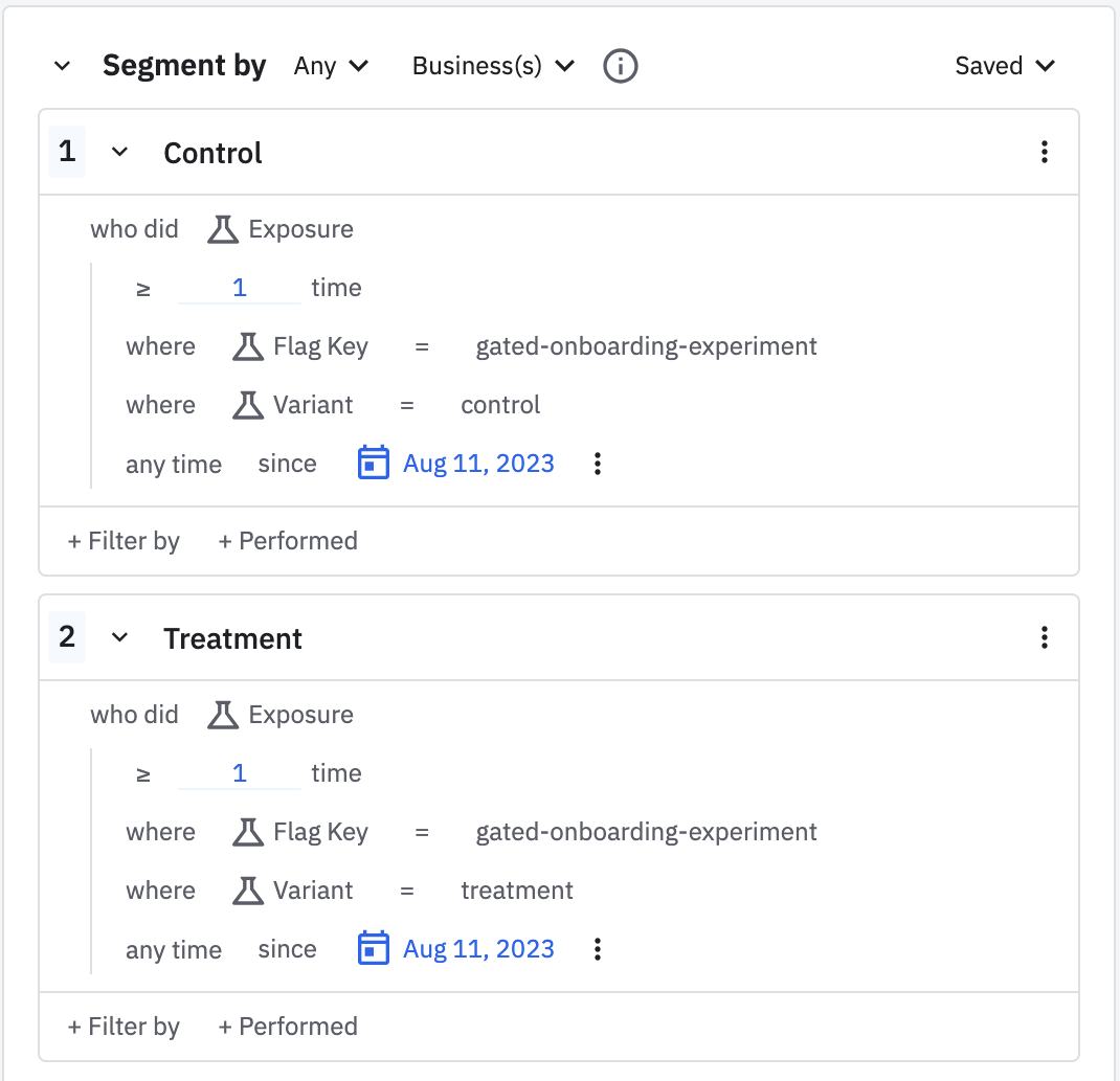

  3. Select your analysis unit or group type (for example, Any Users) in the Segment By module.
  4. Create a user segment for each variant of your experiment.
  5. Click Performed to add filters with your experiment's flag key and variant. If you have restarted your experiment, add an experiment key filter.
  6. Set the date range for any time since to match the start date of your experiment.
The results of your Funnel Analysis chart may vary slightly from those of your experiment. This is because funnel analyses and experiments don't handle users who variant jump the same way.
