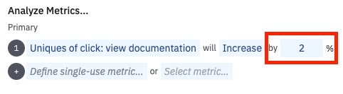

In Amplitude, the MDE is relative to the control mean of the primary metric. For example, if the conversion rate for the control group is 10%, an MDE of 2% (0.2) means Amplitude detects a change when the rate moves outside the range 9.8% to 10.2%.
