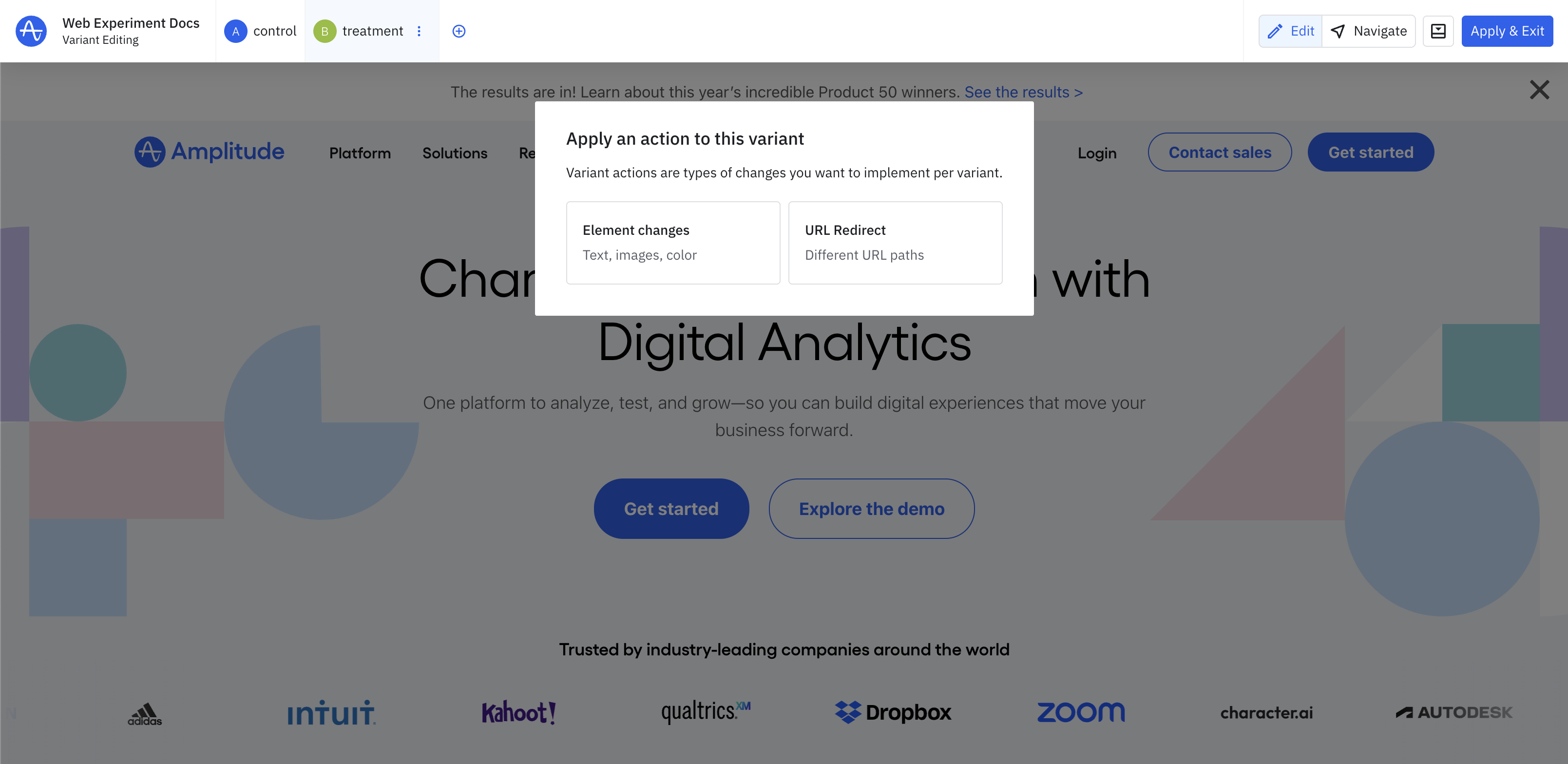

  3. If the script is present on the page you specified, Amplitude Experiment opens the page in the Visual Editor, as a new variant in your experiment.
    You have two options for the treatment variant action: element changes or URL redirect.
    Warning
    If the script isn’t present on the page you specify, or if you have an ad blocker or other privacy extension enabled, Amplitude Experiment can’t open the Visual Editor, and opens the Site Setup panel and prompt you to implement the script.

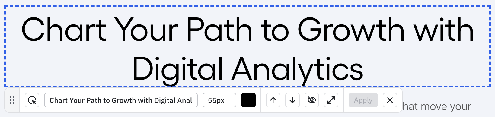

  4. To change text, colors, or other elements of the page’s UI, click Element Changes.
  5. Click the element you want to change.
  6. The editing toolbar opens beside the selected element with quick actions such as editing the element’s content, or move element.
    Clicking the expand icon opens the drawer allowing you to edit CSS style properties. When you're done, click Apply.

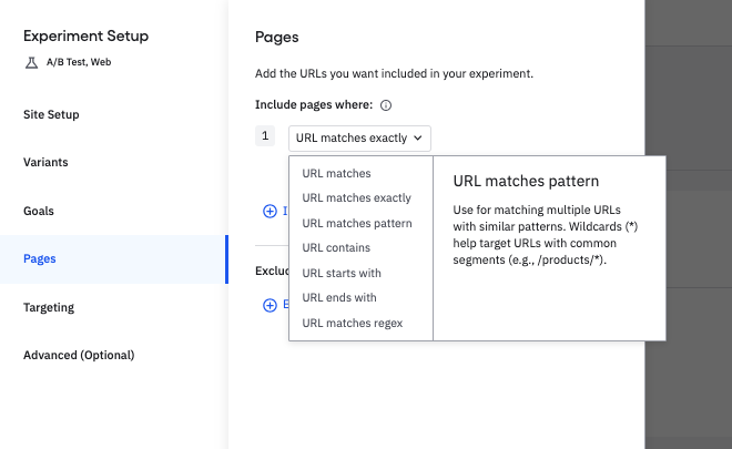

  11. In the Pages tab, configure which Pages your experiment should target. You can create new Pages or reuse existing saved Pages. If you're only targeting the page you originally set on creation, you can skip this step. From the Include pages where dropdown, specify how you want Amplitude Experiment to identify these pages.
    Use the same pattern to exclude experiment from the pages you select. Learn more about managing Pages for precise experiment targeting.

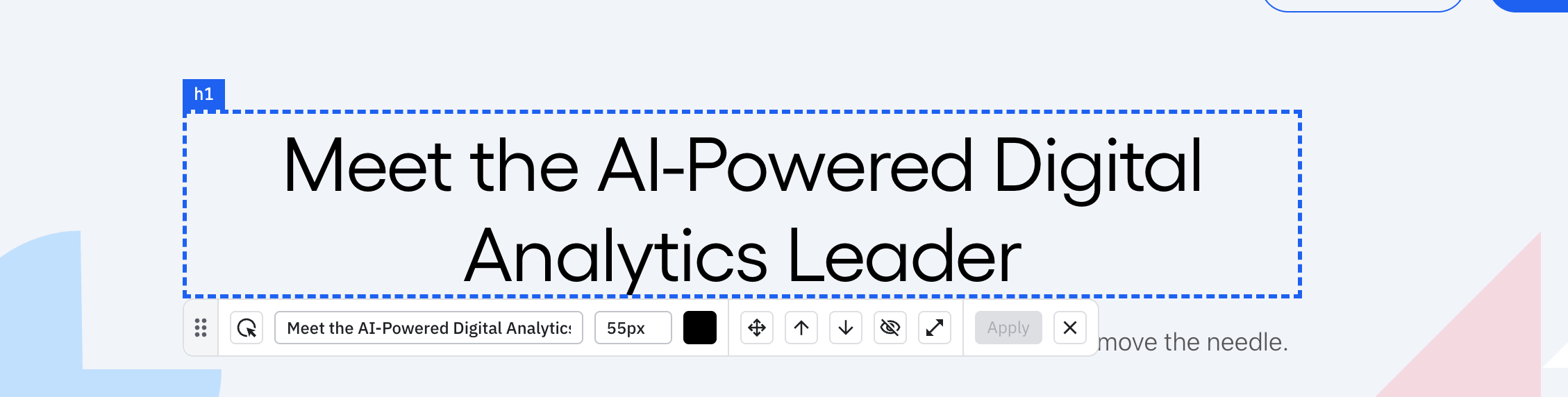

When you click on an element, the editing toolbar opens beside the selected element with quick actions such as editing the element’s content, or move element. On apply, these changes are then added to the current variant.

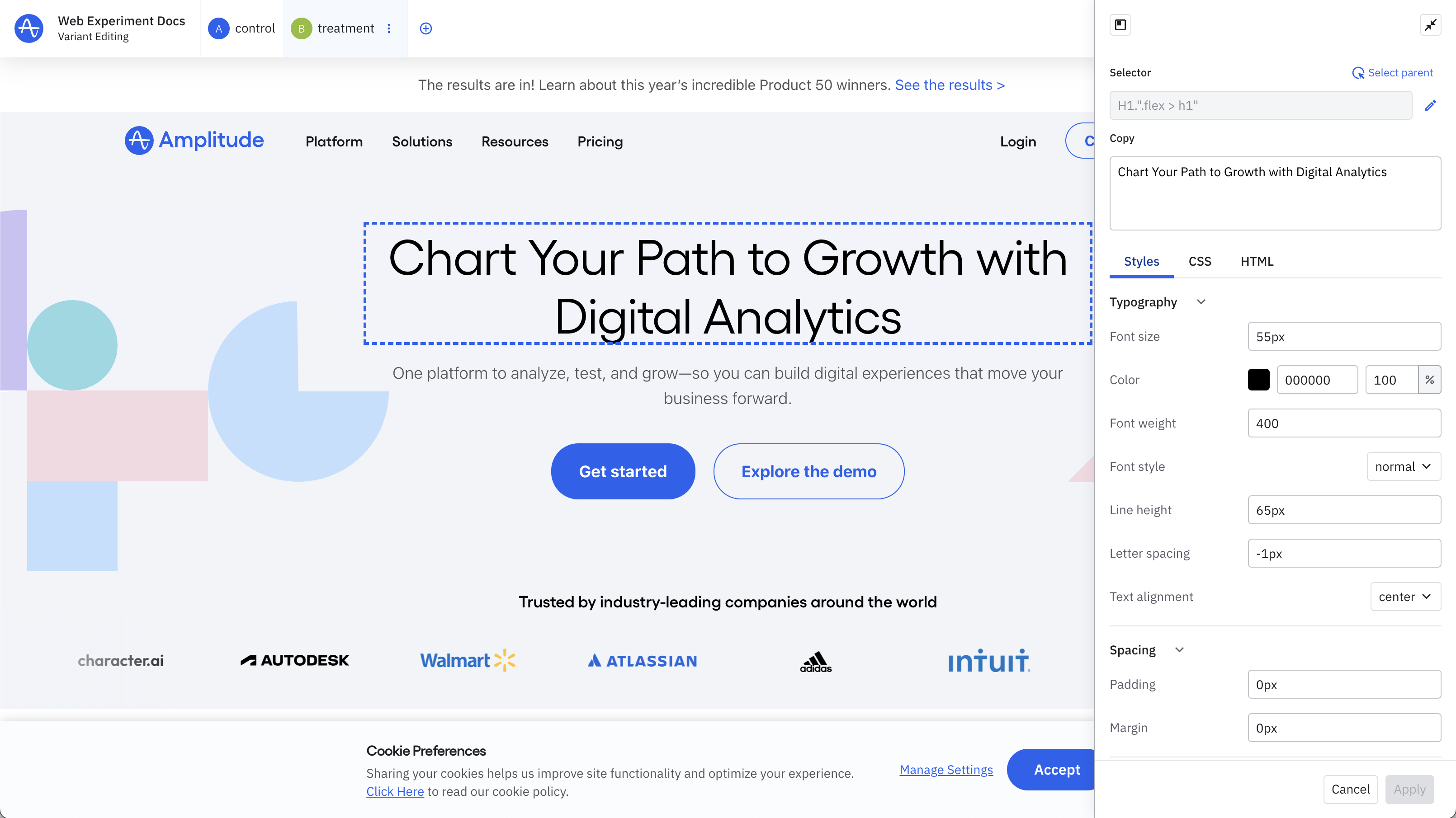

Find CSS style properties, inline CSS, and HTML in the drawer, accessible from the toolbar. When you're done, click Apply.
Selector
At the top is the element’s selector. The selector is a unique identifier for the selected element on the current page. Web Experiment disables this by default. You may need to update the selector if you're running the experiment on multiple pages, as the selector that's generated by default is only unique for the current page. As an alternative, you can edit the selector to select and edit multiple elements.
Styles
The Styles tab contains many frequently used CSS properties. These include: font size, font color, text alignment, padding, margin, background color, display, visibility, and more.
CSS
The CSS tab lets you define any CSS property and value, which apply inline to the selected element.
HTML
The HTML tab lets you edit the HTML contents of the selected element.
