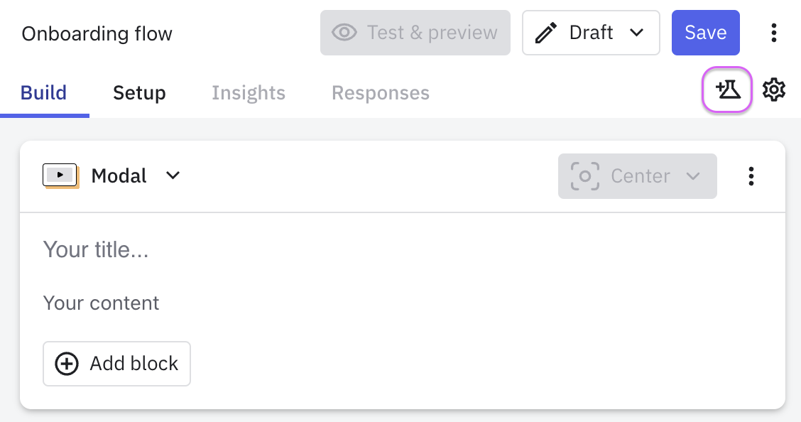

To add experimentation to your guide or survey, select Add experiment.
After you add an experiment, Guides and Surveys controls the experience, and Experiment controls user targeting and variant distribution based on the experiment type you choose.

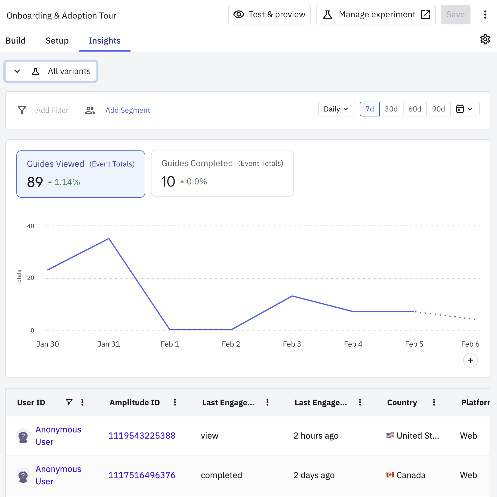

The Insights tab is the dashboard where you track how users engage with your guide or survey. Monitor trends in views and completions over time, and track how different variants perform relative to one another.

Performance overview
The top chart on the Insights tab is the Performance Overview. Amplitude displays high-level metrics that track how your guide or survey is performing:
MetricDescription
Guides / Surveys viewedThe number of times the guide or survey was shown to users.
Guides / Surveys completedThe number of times the guide or survey was completed by users.
Trend graphTracks the view or completion count over the time range specified in the date range selector.
