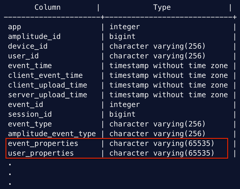

Another shortcoming of the previous schema, which slowed down query times considerably, was that all of the user and event properties were dumped into JSON columns. So we had one column, user_properties, that held a JSON string of user properties, and another column, event_properties, containing a JSON string of event properties.
If you wanted to query on any user or event property, you had to use the json_extract_path_text function to parse the entire JSON and extract the specific property you were interested in. We observed that this json_extract_path_text function was consistently the most CPU-intensive computation on our Redshift clusters.
A portion of our old Redshift schema. As you can see, the event_properties and user_properties were each a giant JSON string that could contain up to 65535 characters. To query on one of these properties, a customer had to use the expensive and slow json_extract_path_text function.

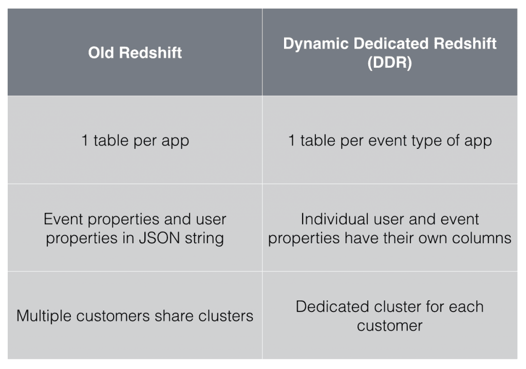

Breaking out individual tables for each event type
Rather than having one table for all of an app’s events, each app’s data is now partitioned by event type. Events belonging to a specific event type will go to their own table; for example, there would be one table containing all ‘Add To Cart’ events, and another table containing all ‘Checkout’ events. This means that when you want to query on a specific event type, the query will only need to scan through the data for that event type, rather than all of them.
Dynamic schemas
Now, this next part wouldn’t have been possible without our first decision to split each event type into its own table. Remember how we were storing all event properties in a single JSON string? Now that we are splitting events into their own tables, we can extract event properties into their own individual columns in their corresponding event type table.
This cuts out the computationally expensive step of using json_extract_path_text. If we hadn’t decided to create event type tables, we never could have extracted event properties into their own columns.
Imagine an app with 200 event types, where each event type has 10 properties: adding 2000 event property columns to your already massive table would have been a disaster. But, if you have 200 separate tables for each event type, adding 10 event property columns to each table makes a lot of sense and is totally doable.

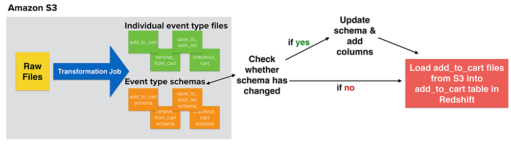

Figuring out how to automate this process and create a truly dynamic data schema was the biggest challenge we faced in this process. We wanted each event type table in Redshift to have its own schema, with columns for each of its event properties. These tables would then update as new event properties were sent, adding columns as needed.
In our architecture, we have raw event files (in JSON format) in Amazon S3 that we then load into Redshift every hour. To create a dynamic schema, we have a transformation job that takes these raw files and does the following:
  1. Read all the events in the raw file and write them to an individual event type file .
  2. Create a schema file for each event type, with individual user and event properties pulled into their own columns.
In the example below, we’re looking at an e-commerce app with events like add_to_cart and checkout_cart.
This diagram illustrates how we construct and maintain our new dynamic schemas.
Once the transformation job is done, it’s time to load the data into Redshift. First, there’s a check to see whether the Redshift transform schema for each event type matches the current schema in Redshift. If the schema has changed, the current Redshift schema will be updated, with new columns added as needed. Then, data from each event type file in S3 will load into the corresponding event type table in Redshift.

In addition, each customer now has their own Redshift cluster, as opposed to the previous multi-tenant system. This means a customer’s query will never be impacted by another customer running a monster-sized query, or from loading another customer’s data into Redshift.
